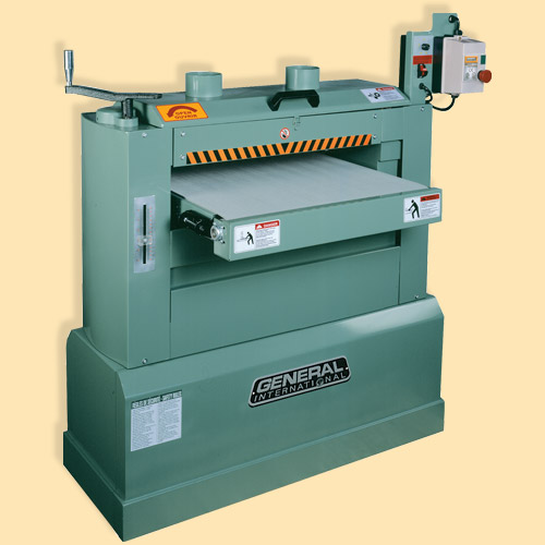

Have you considered the double drum sanders? I have a General International, 24 inch, that I load with 80 and 120 grit paper, it sands up to .......24 inches......in one pass. This is it:
I know that this machine exists in a number of other brands also: like Grizzly, King etc!

About how much does this General cost??
Approx....
Thanks, Walter
PostPosted: Mon Sep 12, 2005 10:21 am
Hi Walter,
I am up in Canada where it is listed on the House of Tools website for $1999 CDN and $1717 USD. I bought it with a 20 inch planer and a 24 inch re-saw and I know I didn't pay close to 2 G's for it but I can't re-call exactly what I did pay, so I think you can find it cheaper than that.
I just checked Busy Bee Tools website and a Craftex (looks the same but a differnet paint job) is $1625 CDN.
Hope this helps!
ShaneShane Neifer38607.8077546296

I know a lot of people don't like Grizzly but look at this:
General International 24'' Dual Drum Sander - 1720US
Main motor 3HP, 230V, 1PH.
Conveyor motor 1/4HP.
Maximum sanding width 24'' (610mm).
Maxiumum thickness 5'' (127mm).
Minimum thickness 1/4'' (6mm).
Minimum length 5'' (127mm).
Drum diameter 5'' (127mm).
Variable feeding rates from 6 to 30 fpm.
Heavy duty base and frame.
High quality conveyor belt.
Table height controlled by large hand wheel.
Magnetic safety switch.
Dual 4'' dust ports.
Depth scale in SAE and metric.
Separate switch for conveyor belt.
463 lbs (210kg),
Grizzly G1066R 24" Drum Sander - 1,325.00
5 HP, 220V drum motor drives 2 aluminum sanding drums
Handles stock up to 23-1/2" and 4-1/4" thick
1/4 HP Conveyor motor provides 11 FPM feed rate
Sand paper installs easily onto the drums
All steel and ball bearing construction
2 - 4" dia. dust ports for easy hook-up to a collection system
State-of-the-art computer balanced drums
Powder coated paint
Approximate shipping weight: 430 lbs.
For the same price as the General you can get the Grizzly 24" with Variable Feed Rate Control.
I've never had a problem with their stuff, we've got a Grizzly resaw, oscillating spindel sander, 14" bandsaw w rise and one of their dust collectors.
They also have pretty great tech support.
I accidentally left the feed rollers on the resaw loose and they came off and got sucked into the blade, they expressed me brand new feed rollers free of charge.
The only problem we've had with their stuff that wasn't out own fault was their jointer had faulty wiring on a breaker in it. They helped us fix the problem over the phone.Jason38608.0091319444

Uh, the General has a variable speed as well and don't believe the 5 HP for the Grizzley. Hp is meaningless as it can be tested different ways. I am surprised that the Grizly is only 30lbs lighter but still, 30lbs is a bit of weight, where do they cut back to get the savings. I am not saying the Grizzley is a bad machine, it's good for the price which I believe is about $1000CDN below the General List Price. From what I hear it is as good as the Craftex and toolex machines. The only problem I have heard of with General tools is that they are more expensive than the others but right now with the sales they are having they are in the same ball park. If you can get a General for the same price, get the General, it is much more machine. Mind you I'll admit that the Wood master mentioned earlier is also a really good machine,right up there with General. I know two different shops that have both of these machines in them. Both had a Grizzley and then got a General. From what they have both told me the General runs 8 hours a day and the Grizly only gets used when they need an extra machine. Just my opinion of course.arvey38608.0597453704
PostPosted: Mon Sep 12, 2005 5:24 pm
Posts: 574
State: BC
I know what your saying ;)
I didn't notice it had variable feed, so the comparable models are really the same price.
CVT Inc.
